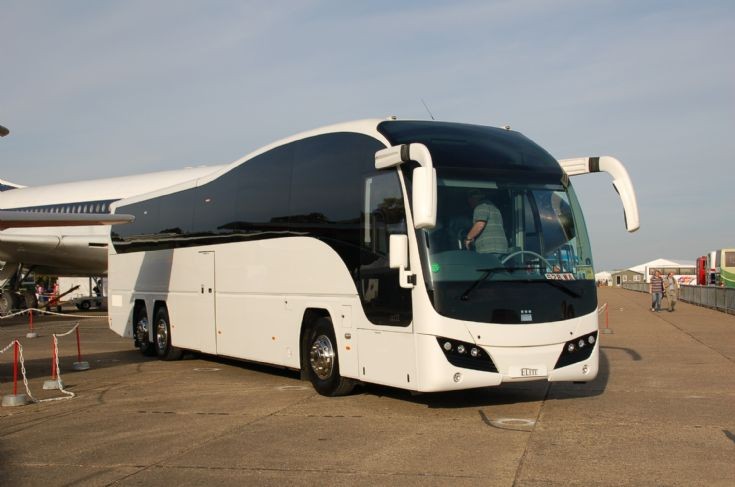

present plans are to remove skin down to frame and use that frame to attach lexan to using the same procedure they use to install auto windshields gives bigger window area and does away with rubbers paint frame members black..considering a double angle trim piece on front edge...MarGuard was only 60$ more so I told him to include the coating.:Thanks Clifford:
My existing windows units (maybe 3/4" thick) are simply bonded into the window apertures with Sikaflex or simiar. The outside face of the glass is flush with the outside face of the steel frame, with a flat strip of black plastic covering the join. A very lightweight aluminium trim piece is rivetted behind the glass on the inside - again I think it's there just to hide the gap rather than being required for any engineering reason.
I think modern buses which have completely flush glazing are done in essentially the same way, but that their double glazed units have 'stepped' edges rather than flat ones - ie. the outer pane of glass is bigger than the inner pane in order to cover the Sikaflex join (the glass itself being black rather than transparent on the edges). There's no reason this couldn't be done with Lexan to achieve that state-of-the-art look.

I'm not a Privy -- er, Provost -- driver, so I don't know the one model from the other, but I will tell you that you are going to get a window-by-window look anyhow if you skin the coach with sheet Lexan.
The Lexan windows you would buy from Prevost are pre-formed and hardened in machines.  The sheet you can buy is flexible and soft.  That means that it will wrinkle and bulge between the pillars.  As you look in your mirrors, you will have a "swells in the bay" effect.
