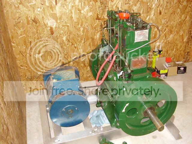

Here's a nice 7 KW Lister/Kohler
NeoplanAN440
nice lister petter!

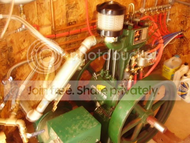

here is the lister cs i was talking about

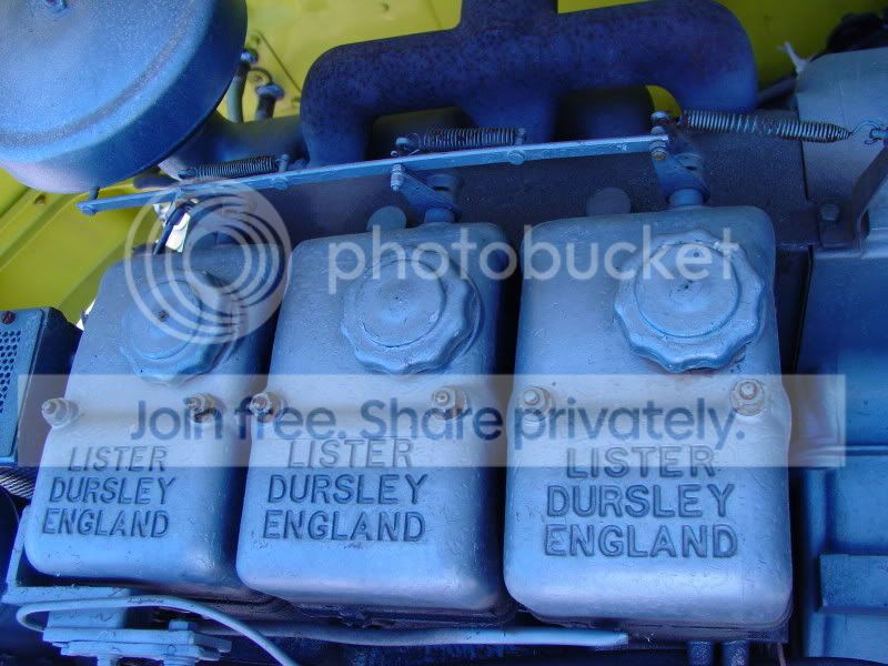

NeoplanAN440
and its bigger brother
