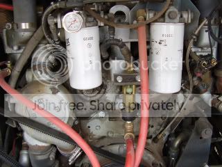

i use a sightglass to see my fuel inlet and outlet,and a pressure and vacuum gauge to monitor filter condition!!!! i like to have more input ,then not knowing whats going on!!!
my cents or maybe dollars
on closed loops
NeoplanAN440
sightglass with vacuum gauge on inlet
pressure gauge before secondary filter

the vacuum gauge i found at JEGS. its liquid filled as all the pressure gauges i use.

on dino i would use the pressure gauge behind the secondary.
the orifice sets your fuel pressure to about 15psi,when the filter gets bad it drops!
i use the same secondary filter for wvo and diesel.i know it slows my purge times,and there will be always some wvo disolved in the filter.i had some problems with pumps (on other engines)and injectors,when switching from cold diesel to 170F WVO.the plunger in the pump would expand faster then the body and causes it to seize!
in order to get these temp diffs a little slower,i run the same secondary on most of my systems.it gives a slight mix of the fuels on switch over,and the temp change takes a little longer.
maybe a detroit wont care,but i also dont know what the head passages would say when they get stone cold diesel after running all day 170F wvo.
with my pressure gauge in front of the filter,i can see how viscous  (hot) my wvo is,and also if the pressure raises i know my filter starts clogging up.
on diesel i have 15psi fuel pressure before the secondary.
on wvo,even at 170F i have 20 psi in idle. (so much to wvo is the same as diesel when hot)(it only looks as liquid as )
if my wvo temp drops to 140 i allready have 28 psi and up.cold wvo will show 40psi etc....
thats just my way how i set it up,from problems i had.if i could get more space on my dash,i would measure even after the filter and .......so many ideas.maybe no time to drive,as i like to be in control!
