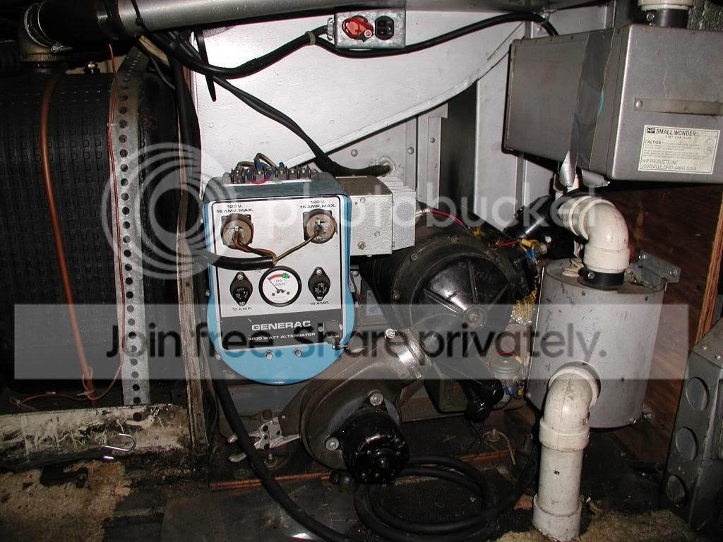

I just removed one of those from my bus since there was no need for it with 2 - 2500 watt inverters now installed. It is 3000 w 24 v belt driven generator and was labeled as an MG set?. Was probably a good source of clean over the road power in it's day and still is if you don't want inverters or run the gen set while traveling. Here is a picture of mine when it was in the bus.
robertglines1
Thanks for info ;I have learned more today and food for thought...Bob 63 and learn every day
