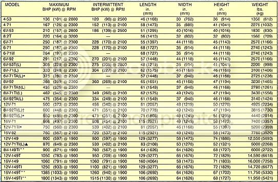

Is there a chart (or website) that does engine comparisons?  I'm new to this bus thing. Tried to do a search and couldn't find what I want.  6v72 versus 6v92 versus 8vXX; etc. with and without turbo, etc.  And where does a series 60 fit in the picture.  When I start my bus hunt, I want to have an idea of what to look for.  Power, performance, economy.  Am I asking the impossible to want the information distilled into an easy to use format?
I'm tired of  my Class A gasser crawling up hills, and having a love affair with every fuel pump. :)  So when I begin my purchase search, I want to get something that will make me happy to start, rather than face a repower in the conversion process.

try--> http://www.adieselengine.com/new_page_1.htm
and see attached file: it's a Canadian STATIONARY engine study (short form / long form) - has some usefull info -->

6V-71 and 6V-92 are virtually the same engine externally.  The 8V-71 is a bit shorter then the 8V-92 because of the big crankshaft vibration dampner on the 8V-92 on the front of it.
Big block engines include Cummins NTC/N14; Caterpillar 3406/C15/C16, 3408; Detroit Series 60.
Small Block engines (read a whole lot easier to install) are Cummins M11/ISM, ISL, ISC; Caterpillar C12, C13; Detroit Diesel MBE 4000.

I have had a number of folks tell me that the actual block of the 8V71 is 2" longer is it just the dampener/balancer that makes it longer?
without stealing this thread, why wouldn't the cradle for the 71 work for the 92? oil pan, oil cooler, i thought none of these were interchangeable.
Rickb
divinerightstrip
The Bus Girl
Rick, it is the crank and the oil pump that make a 92 longer the bare block on the 71 and 92 are identical in length so are the heads.
The 8v92 weighs several hundred pounds more than a 8v71 also
