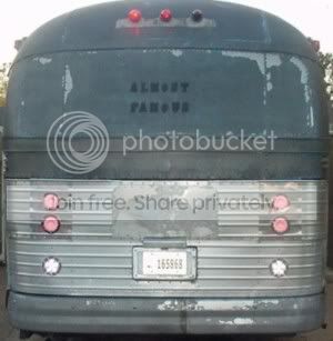

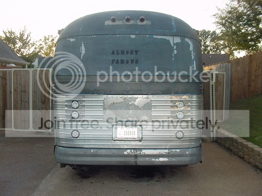

I installed LED backup lights on my bus and they do an OK job of illumination. The P.O. of the bus had fog lights bolted to the back of the bus that looked just awful and made washing the bus difficult because they were not recessed into the back panel. I use the backup lights all the time in and out of my driveway and in and out of parking at the venues the band plays at. More then anything I need to install side lights on the bus to illuminate what is on the sides of the bus. you would be supprised how many people park real close to this big beast and with a dark color car at night it is difficult to determine how close they are.
Here are photos showing before and after the lights were installed.
See the rectangle fog lights just above the round red tail lights
Now it is much cleaner looking with the four upper lights for tail brake and turn signal and the lower lights for backup lights.
And with the lights off they all have clear lenses...
