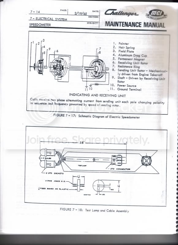

The MC5A stock speedometer
The electric speedometer consists of an electric sending unit driven by means of a short flexible shaft connected to the conventional drive. A four wire cable is connected to the sending unit and the indicator by A/N (army navy) type connectors. Battery current is supplied through a single wire to the brush holder on the sending unit. A grounding wire is connected to a ground terminal on the sending unit.
This is the poop from the 5A manual. should be close I hope.
My bad I see you have an auto ooooops.

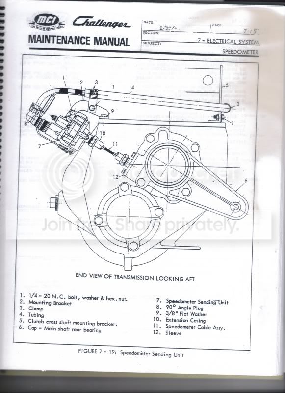

According to the service manual the bus can be equipped with two types of speedo. The first tool you should obtain with these beasts is a service manual!!    JIm
