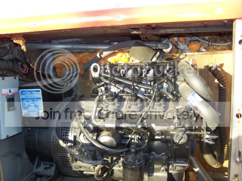

Airbag
Hello Glenn
Here are a couple of pictures. It is as the PO installed it. I have no idea how he has plumbed it into the cooling system of the DD. It is not overheating. I can dig further into it if you like and maybe I can find out.

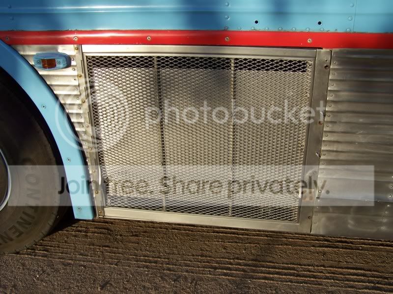

Notice the screen on the door has been covered with a sheet of aluminum, Maybe I should try removing it. Any thoughts anybody?

Tenor
I agree with Loverbus.  I just did that check after finding out that I had the same problem that you did.  I had my wife watch the hertz number on the inverter while I adjusted the rpm.  It brought me up a couple of VAC and my air conditioners, inverter, fridge ran sweet.
I would definitely learn how your system is plumbed.  It's a nice unit!
Are the original vents in the floor still open and do you have a round access door from that compartment to the first bay? (my mci 7 does).  You could put a squirrel cage fan in a box in the first bay.  Pull the air out of the AC compartment and push it out the floor of the first bay with a hole/screen.  The original louvers in the AC bay would make good intake ports.  I did the reverse on my bus.  The genset is in a box in the first bay, the round access port connects to the squirrel cage in a box in the AC bay with the radiator facing the front.

edroelle
The following is guidance, in addition to your breaker popping comments.
Your generator head needs cool air to run efficiently and reliable.   The generator head intake is toward your left, forward in the bus.  You should have about 4" to 5" of clearance and a source of fresh air.  The generator head exhaust is from the grille, adjacent to the engine housing.  The air from the generator head should be routed outside your compartment and away from the intake.
The MCI 8 has marginal engine cooling.  This should be considered in your generator cooling.
You have a very nice generator.  You don't want to compromise it with a poor system design.  Discuss this with someone knowledgeable and can look your design over, or you can contact me.
