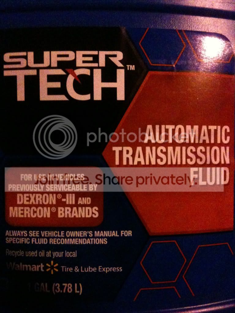

Oregonconversion
I can not see anything in the window of my PS glass. How do I know what to refill with? SAE 10 or ATF. How do I find out what is in there in my 8?
1977 MC8
8V92 HT740
You can take the top off the reservoir and dip a little fluid out, if it is bright red it is power steering fluid, if it is oil coloured amber, it is engine oil.
Tony LEE
Can you even get 10W engine oil nowadays?
Oregonconversion
Took the top off and it was bone dry. Kinda smelt like ATF bilut I took the hose off and I was right. Will this ATF I got from walmart work for the PS and my Allison transmission?
1977 MC8
8V92 HT740
buswarrior
Sure!
Why wouldn't it?
