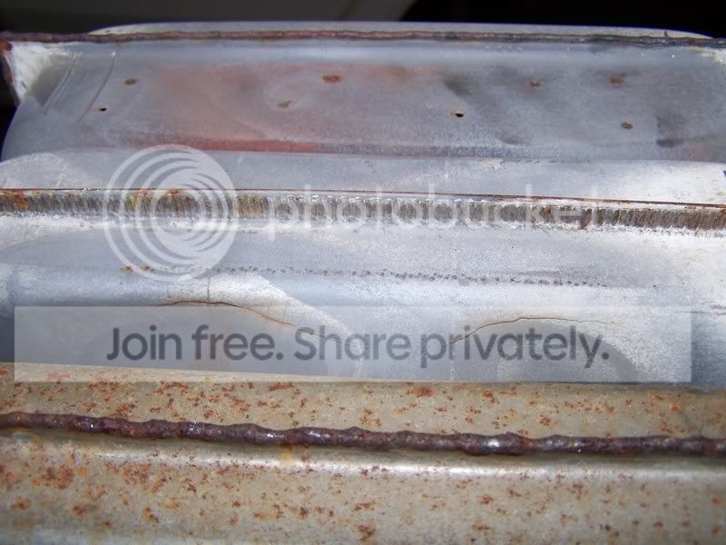

Well it's late and I'm done with the screw drivers in the garage disassembling the heater and now it's time for another kind of screwdriver.

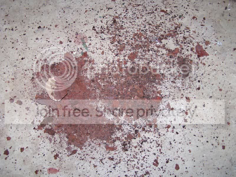

If anyone one is running one of these older units and has not look at the firebox I strongly recommend doing so and soon or having a monoxide detector in the bus. Mine has some bad cracks and alot of rust inside. You can see a couple of spot welds that have blown out letting combustion products into the cabin. The pile of rust on the floor is what came out of the firebox. I wonder if mine has been repaired for you can see the outer cans have regular welds and the middle can has a friction welded seam. Odd
Tenor
Definitley time for a new one!

You are right! The only real choice for my space is the suburban furnace. I sure hate to lose the quality of the older one with its metal blower and squirrel cages. The new ones are all plastic "yuck". Not much choice for I haven't found a new firebox for the HF.
