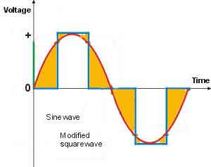

It's hard to communicate in words but diagrams are easy- here- In the illustration a squarewave is shown in green, a modified square wave is shown in blue, and a true sinewave is in red.
The basic reason that modified sine inverters suck is that any energy that is not exactly on the red line is "harmonic" energy, and it manifests itself as RF interference, excess heat in induction motors, etc.  In this diagram, all the energy your refrigerator motor won't get to use is in the yellow areas, which is energy that will get converted to excess heat and RFI.
In this diagram is shown what a "better" modified sine wave inverter might create:

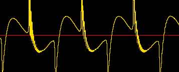

But the big deal is that no matter what the theoretical waveform "should" look like using a modified sine inverter, depending on the load the actual waveform can easily get as messy as this:
(and this is what mine pretty much looked like under load)
