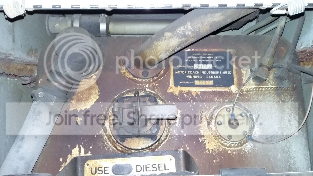

BW here is a picture of what I got to work with.
Geoff I looked down in there and there is a plug at the very bottom, but I think I would get all the junk on the bottom of the tank ??? I do mostly try and keep the tank full very seldom do I let it get below a qtr tank
Thanks Jason
buswarrior
Whew! ok, that's a normal tank.
You have the aux fuel tank in the bay?
The centre high attachment is the vent to the aux tank.
You can re-work that vent pipe, get pick-up and return fittings fabricated into it, the vent won't care if it is somewhat obstructed when you are done. Note that the pick-up needs to go on an angle so it doesn't drop down blocking the fuel fill.
On coaches with no aux tank, that position has a simple round plate bolted in place.
The other piece, with wires attached, is the fuel sender. You could investigate whether you could squeeze the fittings into that plate without interfering with the sender movement.
Deciding the depth to send the pick-up is for you to choose. The return just needs to be into the tank and can dribble from up high.
Cut the pick-up a little shorter than the engine pick-up, to defend against stupidity, or boldly send it close to the bottom.
I will caution to not cut it too short, every inch of fuel in the bottom part of the tank is a lot of gallons, and you will suck air before you wish you didn't, and still have plenty to go for a drive. The calculation to find US gallons is length x width x height in inches, divided by 231.
