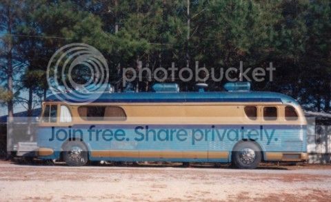

Just a guess here, hub piloted would be the rears and stud piloted would be the front's?  You know the stud pattern speak?

Nope stud pilot front and rear axle on older buses
