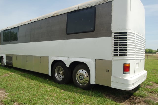

Interesting Adam. Our 102C3 of course now has Renaissance caps so it's now a "flat back" with a normal radiator fill cap up top to the side. Cool.
