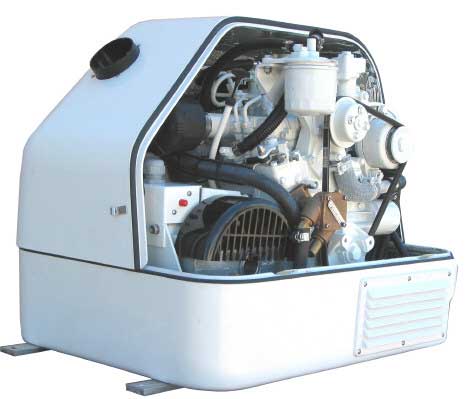

here's a 4.5kw direct coupled kubota @1800rpm   not sure about cooling tho  ???
http://www.ebay.com/itm/Phasor-Marine-4-5Kw-Compact-Generator-/271773800712
