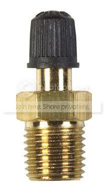

like i said...if you replaced the 90 fitting that the air goes into...with a three way run tee you could pull the run through capped and manually actuate the rack rod to push the rack to no fuel without defeating the shutdown air engine safety system.. beats waiting for it to run out of fuel.
especially since you are re-engineering other things you may not be confident doing...
heck you could put a shrader valve  there and shut it down with a bicycle pump...which would be better than what you had...
