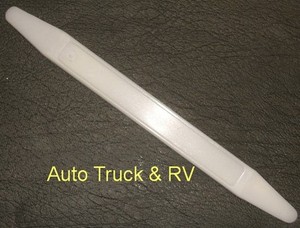

do you have plastic spoons like in the video ?
if so you can use them to put between the glass and rubber and work the channel to stretch it back into shape. do not use metal....
is the lock strip the same as the old one ? then you can take your lock strip install tool and work it repeatedly in the groove that will relax and position the rubber too...often the strip "looks" to big but really it is not...if the tool fits the strip will.
good luck.

i have a couple of these.. the ones that have the business end parallel to the shank don't work well ... for me... sorry about the giant picture...i am not sure you can buy some of these tools anymore...the chisels, yes the others all i can find are pictures.. this one used to be made by KD..cheap but a goodun... :D

One note. Do NOT touch the windshield with anything metal. We worked for probably 3 hours, with four guys, getting our first windshield in. Then it cracked. Turns out we were using 8in steel mudding trowels to try to spread the gasket. That chipped it, and it cracked.
We went to Harbor Freight and bought a bunch of plastic tools. Plastic chisels, plastic screwdrivers, plastic prybars, you name it. For less then $40, we were totally outfitted. When we got just the right placement technique down, we were pros (even replaced the windshield on a reality star's bus, that we are friends with).
So take your time. Get lots of plastic tools. Use lots of straight dish soap, and be slow and careful. You will get it.
