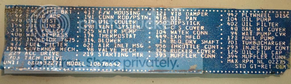

Luvrbus,
I managed to slide this plate off the valve cover.  Maybe it helps?
I can't read any #'s off the turbo yet, but I'll get in there with better light and try soon.
Thanks
well the data tag says the turbo is 701
the injectors are 7G75
6A0432271
Model 10678642

I think that those numbers will aid the guys who have that info in their back pocket.
PS guard that tag with your life.

Engine model # decoder: Note 42 is not a standard 40 = pre 1991 motor and 45 =firetruck
http://2-cycle.mtu-online.com/extras/engine-model-number-decoder
Your engine details:
1-Engine Series: 71
06-Number of Cylinders: 6 Cylinder
7-Application: FF-Auto
8-Rotation & Type: RD
6-Design Variations: TA
40-Specific Model: Pre-1991 Engine
42-?
45-Fire Apparatus
Heres a better one:
http://engine.od.ua/ufiles/DETROIT-Model-Serial-number.pdf
The serial # confirms that it is probably the original motor
6A0432271
431867 being the first produced motor in 1983'
