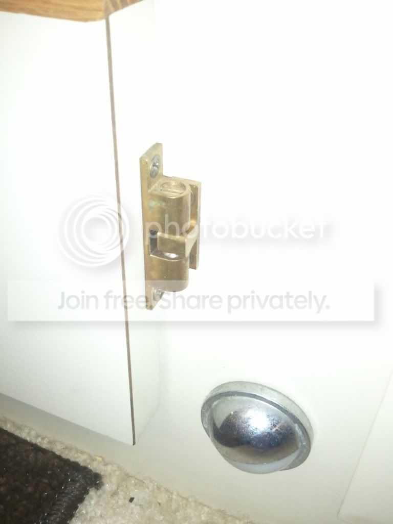

Just A Newell
This is the latch that Newell used in the 80's. You can adjust the tension with the screws top and bottom.
SE Ks, 1986 Newell 8v92
