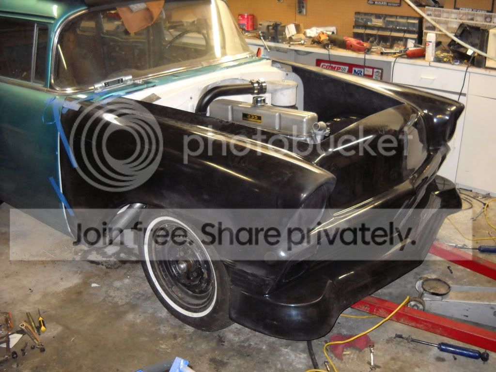

Uglydog56
The cool kids put stick shifts in their 56 chevy's.  ;D
Richmond 6 speeds, to be precise!
