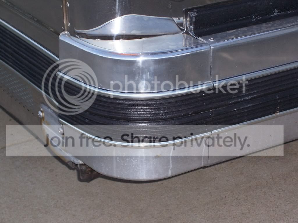

I noticed in another thread that an MC-8 did not have the black rubber pads on bumpers and I was wondering if I can take mine off my MC-9?
also if anyone has done this are they glued, bolted etc and how much of a mess did it leave behind the pads?  thanks

Why would you want to take those very heavy duty rubber pads off?  Those rubber pads are another layer of protection for your bus if you hit something or someone bumps into them.  Leave them on and just put some tire black on them-they look really nice.  Good Luck, TomC
buswarrior
If I remember correctly, they are back bolted.
Disassembly of the bumper required, corroded fasteners, more than likely they will break free of the bond in the rubber on the opposite side, giving you a lot of grief in removing.

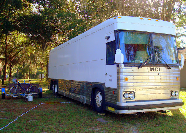

We've been slowly removing ours. Removed all the cladding on the sides and now we're at the bumpers both front and rear. Everyone is right, the bolts are behind the bumper (lift it as if to access the spare tire). And yes, on our coach they are corroded so badly that an angle grinder with a cutting wheel is our only hope. I also agree that the coach needs the cladding/rubber gone. I plan to install some nicer looking trim later.
Here is ours currently. Waiting on a stainless polish and then we'll stick some nice looking stuff on there:
FWIW, that MC-8 with smooth bumpers came that way, it never had rubber covers.  My 5C is the same way.  Must have been different options.

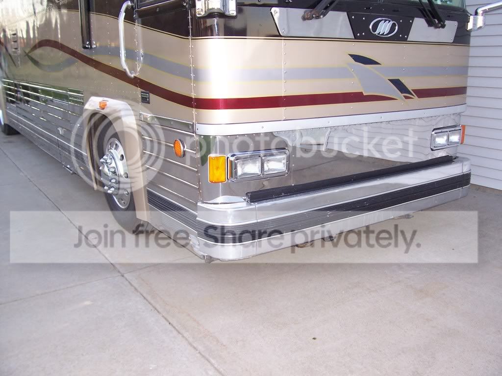

I did exactly that and for the same reasons the mine were getting deformed from the steal that is embedded in the rubber rusting. after removing the rubber I found my bumper to be really pitted and even had a few holes ate through in places. I polished the bumpers then installed 2 rows of some molding for a Chevy pickup I got from JC Whitney all around the bus. It looks good plus I still have a little protection. Jason
jmblake: Your coach looks amazing. I have some slightly thread relevant questions for you (if no one minds).
1. Love the look of your new trim...did you angle grind off the old bumper mounts?
2. LOVE the look of your polished front end. How is this mounted? Does it float on the bottom near the lifting front bumper? I want to do this.
3. Love your headlamp upgrade...how is this done too?

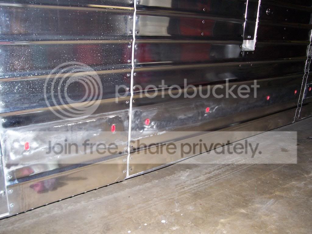

Did mine a year ago and like the look a lot better. Mine were like Jasons in that they were pitted and the bolts were rusted. I just used my Sawzall with a small tooth metal blade. Put in between the rubber and the bumper at each bolt and cut them off on the back. The front I just lifted the bumper and put a block holding it open at each end. I layed on my back and unscrewed most nuts and some just snapped off with an impact. I then ground down any bad spots and filled with body glaze and Wet sanded nice and smooth. I put reflectors over where the bolts were and it look pretty good.
Dave5cs

jmblake
Scott,
Thanks for the compliments.
I soaked the bolts for several days with PB blaster and they all came off with a impact wrench, As far as the polished SS I bought the headlight kit and the new stainless from IBP in Florida and every thing riveted right back in the same holes as the old panels. Jason
