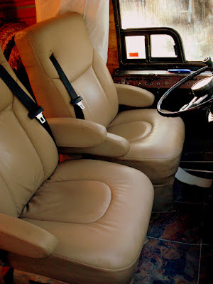

Here are some pics of how our bus is set up. The passanger seat is mounted on a hydraulic ram that is connected to a 12v hydraulic pump. I have a switch mounted on the dash with a up and down position. You just raise the seat up, swing it forward and then let it down right next to the driver seat. When you are done you just return it to the living room furniture.

I would love to shoot a video of how it works, but I live in Alaska and have the bus wrapped, blocked and the batteries removed for the winter. This is a really simple build if you have any fabrication experience. If you have an old snow plow laying around that you don't use because of global warming.  (You have all the parts right there) If you look at the first picture, you will see the ram is mounted right behind the driver seat and in my bus is bolted in the front side of the wheelwell. You have to get that mounted in the right position so the arm will clear everything and set the chair right next to you. You will see in the first picture, the step has a bevel on the right side. That is so the arm doesn't hit the step when you let it down.

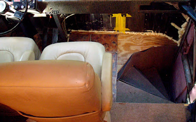

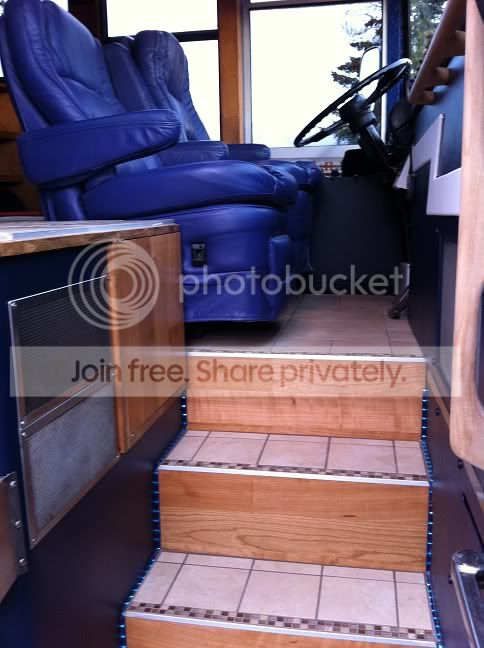

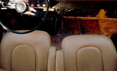

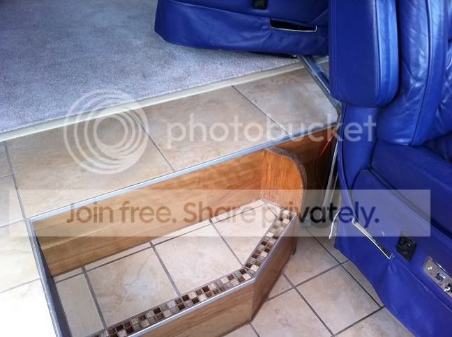

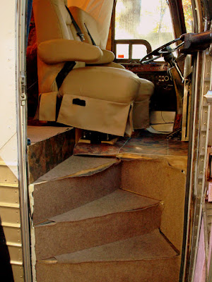

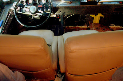

in response to jbnewman, here are the photos of my side stairwell mod. It's not complete, so please ignore the unfinished carpet, trim, vinyl, and spray foam.  :-\ The seat is not locked into it's straight mode, so it looks like it's turned and leaning...ignore that too. This is just proof of concept. Anyway, the seats are mucho comfortable and I now have my cute wife right next to me so we can sail into the sunset holding hands...until the driver next to me cuts me off and I need both hands on the wheel... :-\
Auto shifter underneath the center armrests along with Pbrake.
