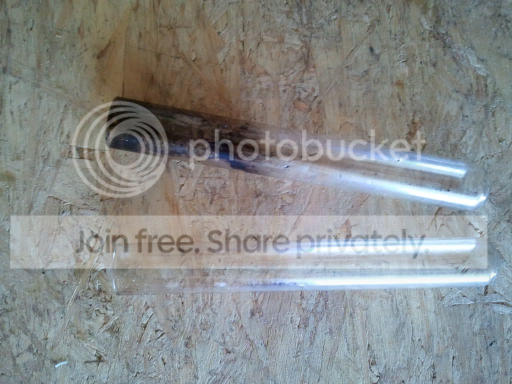

I've attached a photo showing straight from the pump diesel burnt and the other tube is straight from the pump diesel that has been treated and burnt.
Why would you want the byproducts ( carbon / nitric acid)  in your motor / exhaust when you can eliminate it / gain MPG and keep your motor &  oil much cleaner.
