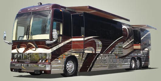

I've always wondered about the legality of that type of awning - ie., the sort that has vertical arms permanently attached to the side of the bus. If the bus was built at the factory to the maximum legal width, attaching something to the sides that makes it wider must mean that it then technically infringes the law (lights and mirrors are of course exempted).
The type of awning shown below doesn't have this problem, and is a much neater and more elegant system altogether - but is a much more difficult retro-fit, and is presumably more vulnerable to gusts of wind as it lacks the tri-angulation offered by the vertical / angled arm.
Those are Girard awning Jeremy they have their share of problems high dollar also a 20ft is over 5 k for the patio side and they have a housing on top you don't see in the photo and they operate on 110v not DC

Ok thanks; whilst on the subject of those awnings - what exactly are they for in the photo I posted? Are they there to shield the slideout windows (which they barely seem to do), or is their real purpose to prevent leaks by keeping water off the slideout roof? If it's the latter it's a bit scary for those of us constructing home-built slideouts - especially when I believe Prevost uses pneumatic seals on their slideouts, which should provide a faultless seal in all conditions.
Those are just for the slides to keep bird stuff,and the weather like snow and rain off and yes Prevost slides do leak like any other LOL
