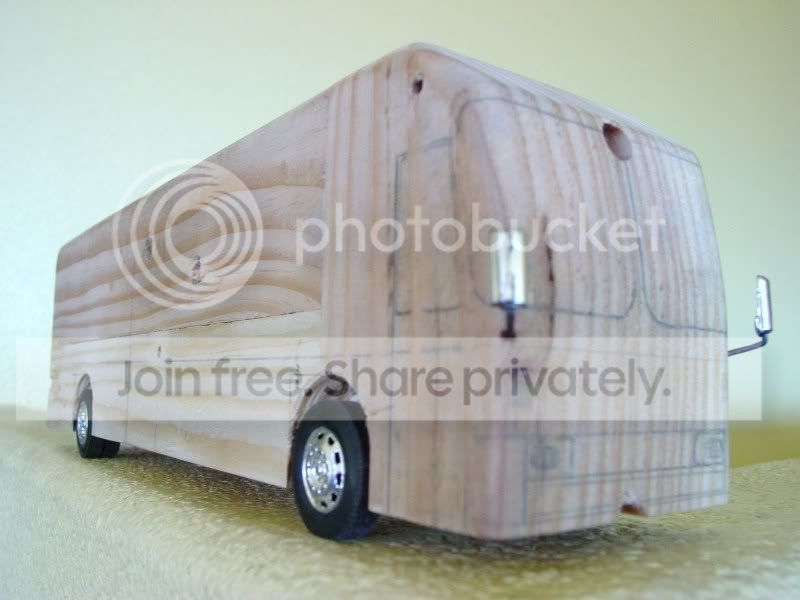

  Agree on most points, rolling toolbox, etc.. But please, nobody start making a "woody" out of a Bus.
To late Paul a guy around Eugene has a GM 4107 woody actually it is pretty neat I'll see if I can dig some photos up for you
