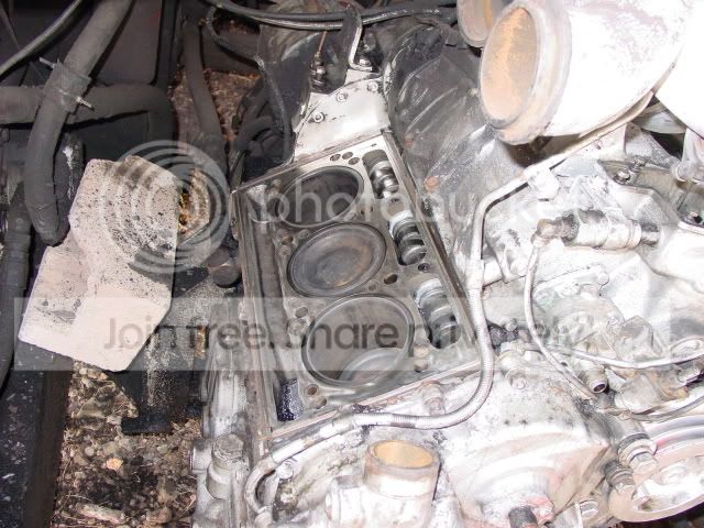

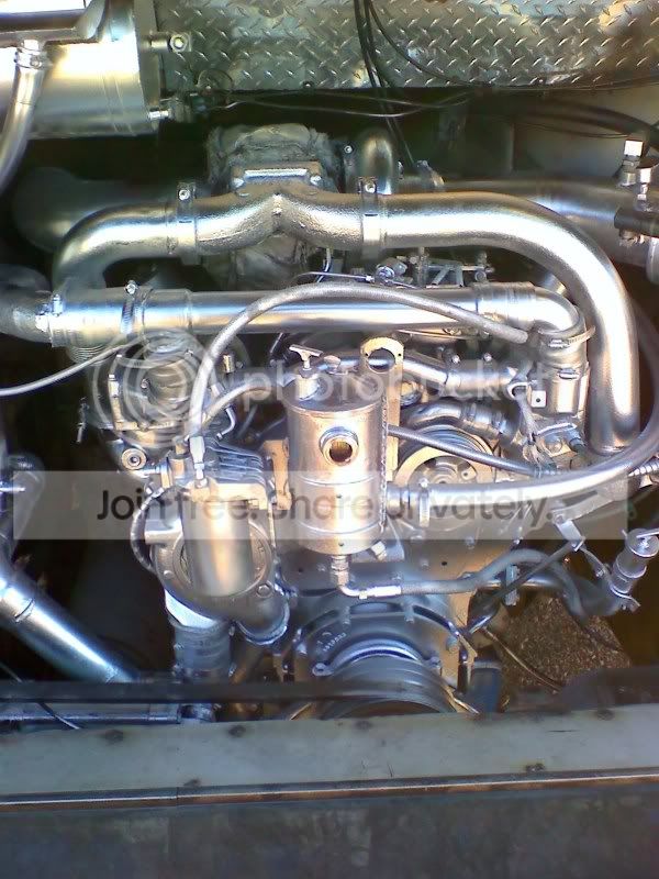

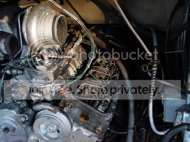

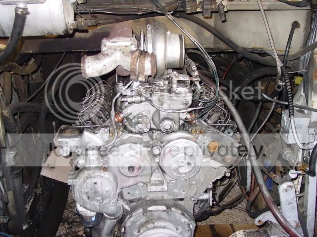

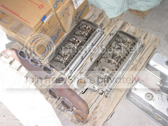

Hey just for reference, here's a 6-92 top end apart. Altough ours is a model 15 (102" wide) still a little tough to work on even for a string bean such as my self ;D
Heads off
New heads
Heads on, and assembled
And completed

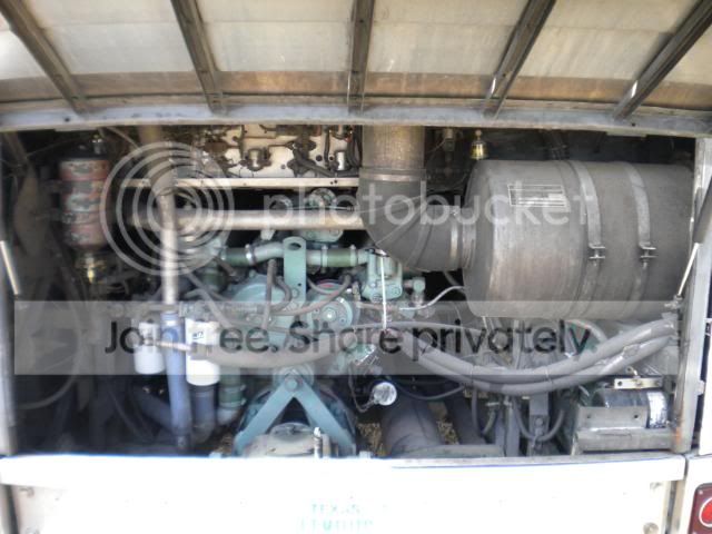

Here's Marc's engine bay
