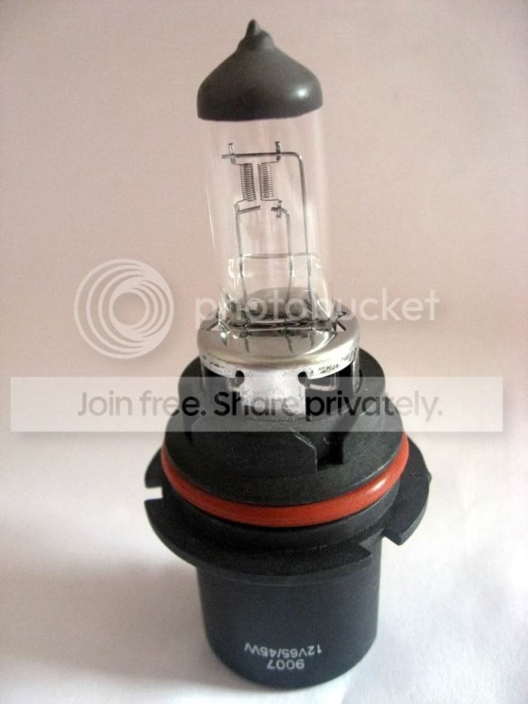

By far the worst HID conversions I've seen are the ones on Fords, Dodges, and Chevy's with 9007 or equivalent bulbs, which instead of relying on a metalic light shield to control light just relies on the 3mm difference from low to high beam as well as a minor output wattage (45W low, 65W high).
HIDs in these fixtures basically output both high and low at the same time, or on the "biXenon" versions they put out LOW+HIGH or just HIGH-out-of-focus and not pointing on the road at all.
