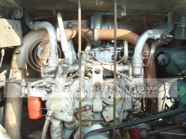

Stupid question... but where is the stop lever on the governor located???

Yacht the only stupid question is the one not asked!
If you'll look directly between the fan belt on you MCI there on top of the engine there is a little air cylinder that pushes out on a lever. That lever is the shut down lever and it won't push out without air, unless you manually push it.

Ok...thanks BK...I know where that is. I did not know that was the governor tho.. I thought the shut down lever only cut off the air intake and I had no idea it would retard the timing to the injectors... I will give it a try..

Yes JR.. We spoke a few months ago. I'm the one who works in Monroe. I've been meaning to catch back up with you to see your bus to gets some ideas and advice but was waiting on it to get a little warmer. I will definately give you a call once it does warm back up. I'm still early in the learning process. As far as the smoke, she clears up almost the second she starts. It is definately a "real" turbo 8V71. Detroit says the serial number tells them it is a 1987 8V71T surplus Military Tank Engine. Don Fairchild was nice enough to also run the numbers and said it was a 350HP engine with the N-90 injectors. I do not have a block heater yet but will put that on my wish list.
