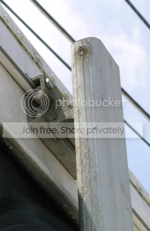

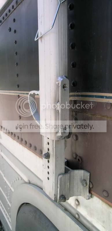

Took photos today for future readers/searchers. Front, rear, top mount.
Chaz

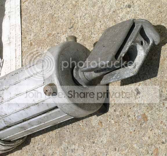

Here are the pix of the awning parts. It's my understanding this is an "original" Carefree awning.
As you can see, I modified the bottom of the arm for two 3/8" locking knobs. Maybe over kill but I don't like things to break.  ;)
Now that it's mounted, and I don't have to worry about messing up any paint, I think I'll have most of it sand blasted and powder coated to match the color I want to paint the bus.
So how do I put the new canopy on?? Do I have to beat those caps off?? I hope it's easier than that as I tried tapping pretty hard - to the point it was distorting - and it didn't budge. And I don't think there are any parts available for it either.

Got my new canopy a couple minutes ago and still no one knows how to put it on? Dang. I guess I'll just try beating on the caps harder. I can't see any other fasteners except the rivets holding the round spacer/rings/studs/ whatever. I don't want to drill them out if not necessary as I don't know if I have any to replace them with.

Thanx Dallas. I can't see if they go thru or not but since you think they do, I'll take the shot at drilling them out. I'd just rather not open that can if it isn't necessary. It just seems odd that a person would have to go thru all that to change a canopy. It is, what I'm told, an "original" Carefree so maybe that's just the way they did it in the beginning.
As far as rivets, I'll let ya know. I'm sure I would have to buy a box just to get 6. And I'm not sure where to go. Goggle will probably be my best friend.  ;D

Drill the rivets out of the cap knock the cap off and there should be 3 rivets that locks the spring and they usually go through the fabric unless you have the plastic lock.
Wow blood tore up hands and a trip the ER to change a awning doesn't get better than that Chad lol sure glad I have Zip Dee's
Wow! Mine is a little newer, but just the same the newer ones have the slot molded into the cap like ours, drill the rivets, and make sure the thing is unsprung . LOL! FWIW I don't know how old the Carefree co.is, but last weekend was the 100th aniversary of the RV ;D ;D good luck Chaz and keep us posted(it ain't over til the large lady sings ;D) ;)
