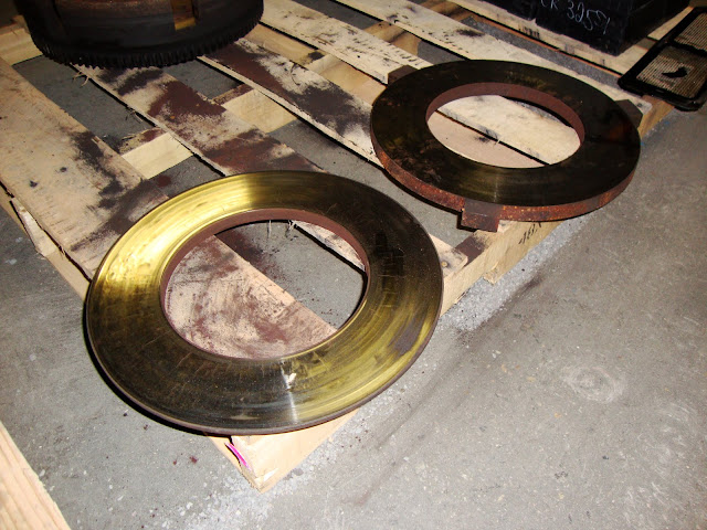

The clutch is a mystery, but the numbers don't lie.
I brought the flywheel surface to a machinist and he didn't think that he'd be able to resurface it because of the high, or "hot" spots on it.  It's .0430" under spec as new.  That's not a big deal because the manual states it can be cut three times, but each time a "shim" needs to be installed between the plate and the flywheel when it's installed.  I found one shim which measures .0320", so I take that it's been cut once and if I can find another shim or two, I'd be able to have the shop cut almost .0500" off and still have it within spec when installed. The machining will cost $150-175.  A new plate is $230 plus shipping, say $250.
Another picture, the flywheel plate is on the left
The friction discs are both under spec by .0100".  They could be reused I imagine, the only damage is the worn spring hubs from all the clutch chatter.
The pressure plate was on the new side, like the friction discs, but since the finger heights were not likely adjusted, it's too far gone.  Heavy heat cracking on only one part of the surface.
Looks like a completely new clutch is needed.  Yikes.

Onelap, for an extra $60 or so I would get a new flywheel, the rest of the clutch rebuild should be $290 or so.
