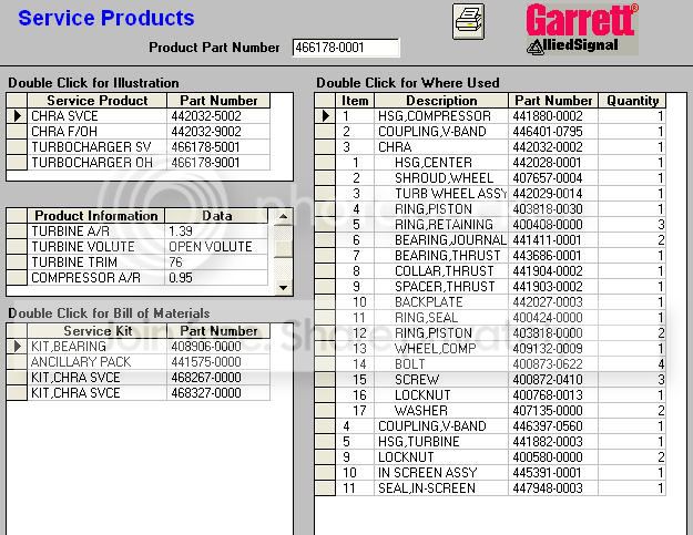

Rick,  here is the factory parts breakdown for your turbocharger.
If you have a chance to remove the turbo and check the turbine wheel.   This will tell you if anything has run thru the turbine wheel.
You have mentioned the FOD damage to the compressor wheel, check if there is wheel rub from trashed bearings.

Zero clearance the turbo feels and spins perfectly, no play whatsoever. Should that reassure me that my motor didn't swallow this debris? That would be reassuring indeed.
First thing I did was spin it and check for wobble or end play felt like a new turbo just a piece missing out of one blade. A small triangular piece about 1/4" across. Looked like it had happened a while ago but since the motor has not run in a couple years that could be the reason for the appearance.
