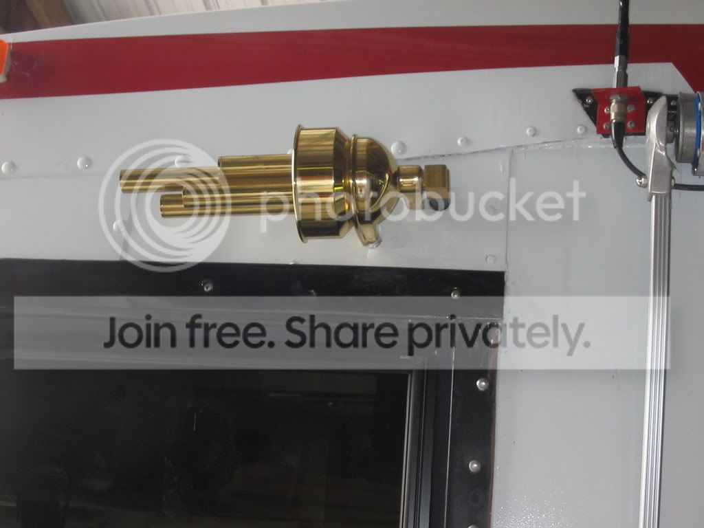

   I prefer the sound of the old steam locomotives.  I got this 4 note brass train whistle from Richard Bowyer a couple years before he passed away. It is plumbed with 1/2" tubing and controlled with a 1/2" ball valve.  This allows you to "play" the whistle.  We also have 2 pair of air horns and a pair of loud electric horns. Each pair is controlled by a separate switch. However, the OEM horn buttons on the steering wheel are labeld EMERGENCY ONLY. It you hit this switch you get 4 air horns and 2 electric horns. If I use my left thumb on that switch and my right hand on the ball valve, well, let's just say "they will hear me".  Jack
poppi
Went to take a picture of mine...and this is what I got
Turns out mine is just like jacks but not as shiney  :-[
