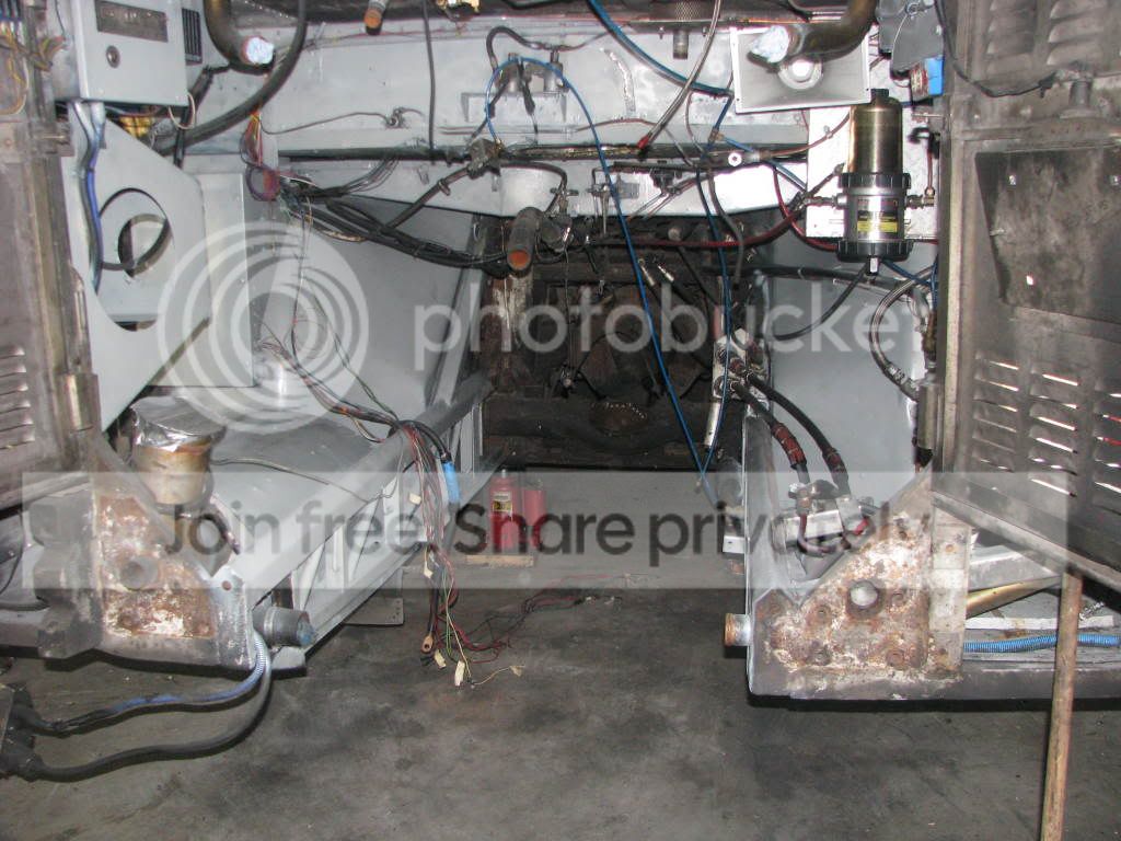

The engine compartment is cleaned and painted. The transmission is reconnected to the engine. DD sent the wrong front cover gasket, so I can't install the front cover off my old engine or the engine cradle (that attaches to the front cover). Probably a trip to DD on Monday for the correct gasket. Still have to torque the flex plate to torque converter bolts and bell housing bolts. Then install new flexible air lines, fuel filter housings and oil fliter housing.
johns4104s
Jack,
The new set up looks so great your make over of the engine compartment also looks great, wow, I wish I were in the area, and could help.
RickB
Jack, where did you get the paint for the engine compartment? What color is that? I think it's the same color I have been looking for to paint my blower compartment but I haven't been able to find it at hardware stores. Let me guess, it's probably a detroit diesel color!!!
Thanks for helping make me a copycat.
Rick
JackConrad
The engine compartment paint is Valspar Truck & Trailer  (premium oil/heavy duty) Gray # 4634.  I am pretty sure I got this paint at our local Tractor Supply (TSC) store.  Jack

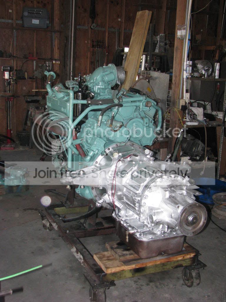

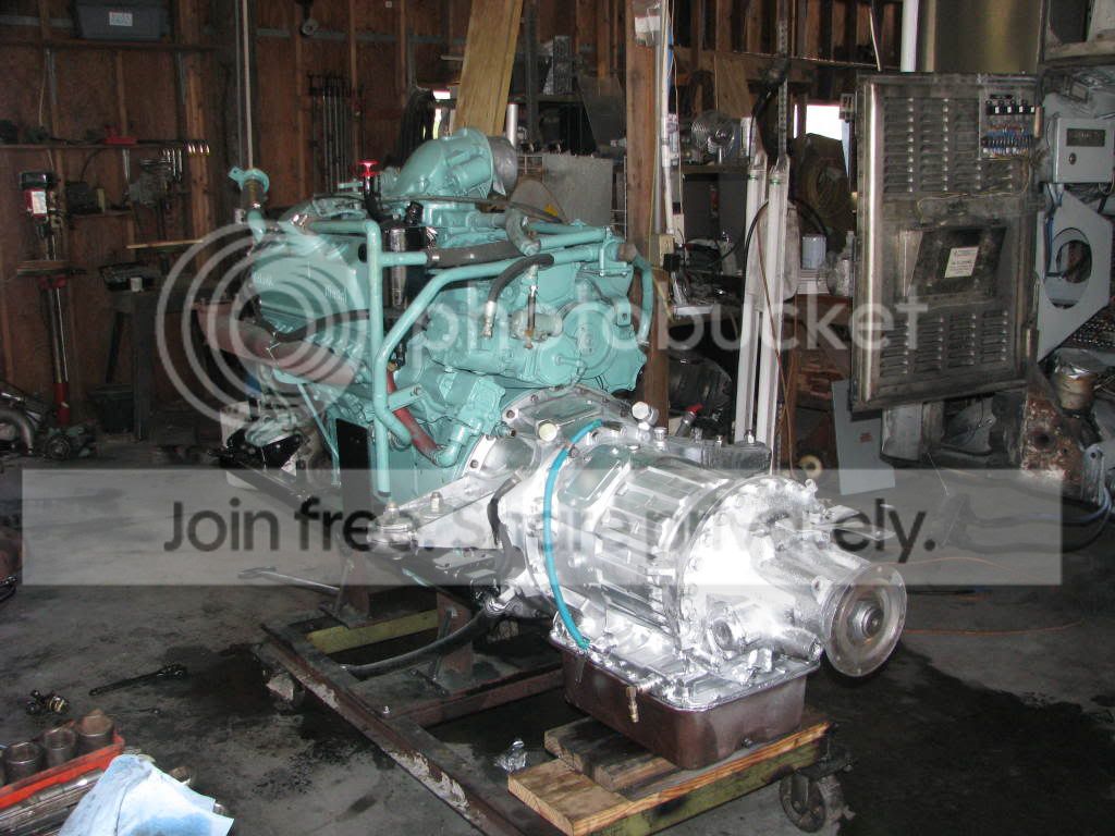

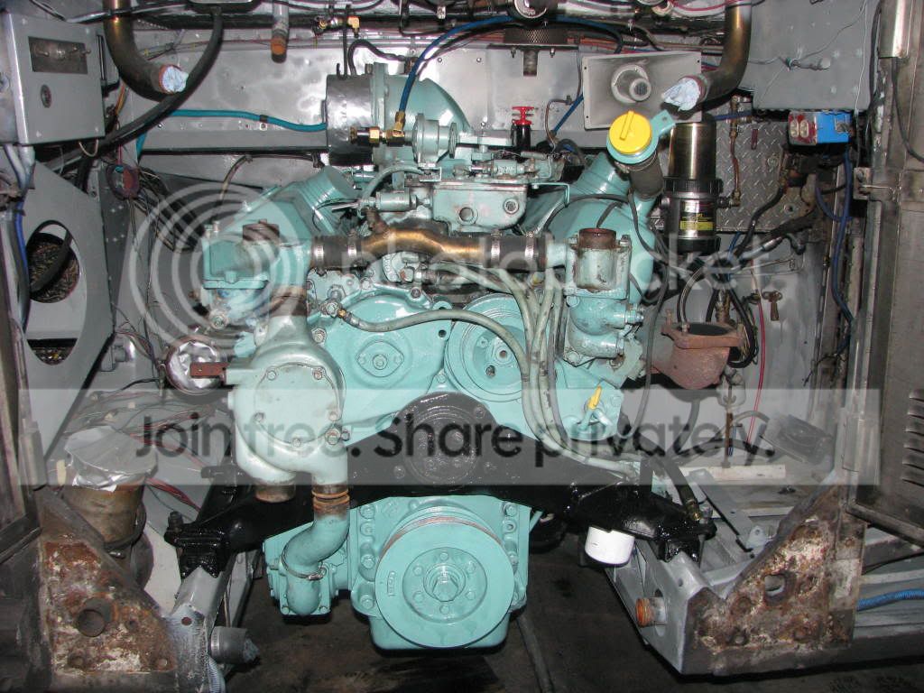

The Engine is in! Still need to connect a lot of stuff but it is in.  Jack
Ready to install
Installed
Lonnie time to go
I must say great job and thanks for all the photos.
You have no idea how much it helps a person who has little DD experience

NewbeeMC9
That oil fill neck is on the wrong side ???
I believe that engine turns the other way!!!!!
April fools!!!!!!        and a hokey one at that ;)
Looks great and I cant wait to see it.  Keep up the good work!!
cody
Engine turns the wrong way? wow, next you'll tell me that nobody else has one forward speed and 5 gears in reverse. lol
RickB
Jack,
Where is your alternator/generator?
Just wondering how you plan to charge your batteries.
