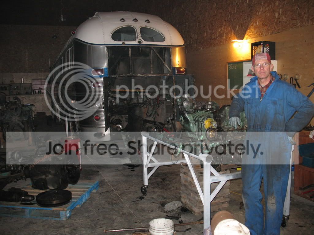

Quote from: lostagain on February 14, 2009, 09:34:18 AM
Here is a  picture
"Whaddya mean, you came in for a turn signal bulb????"
