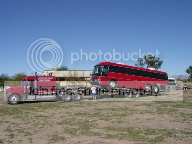

I maybe changing the subject but I think Van tare has his question answered. I was wondering how many miles on your engine since last rebuild and why did it blow up and was it completely toast?
Grant,dont know the mileage since last rebuild,although we just put on new set of heads 100 mi ago after this happened last time due to a faulty radiator wich also was replaced along with the heads.I suspect the hydraulic pump leaked out it's fluid and thus not enough pressure to operate the cooling fan.pulled over when temp started to climb above 190 .I think pretty much seeing water coming from the air box tube that she over heated real good . The gauge had to be off considerable .this is the second time on this motor ,which means a complete new rebuild would have to be in order,and would be a lot cheper in the long run to get a pull out instead which Don Fairchild already had one lined up for us even before we finally arrived in Quartzsite.Insidently Pogressive road side assistance did an outstanding job in getting a Landoll for us and getting the bus back cudos.
David there were at least one senicruiser there that we saw.
Paul ,did'nt see leno but that don't mean he was'nt there

Dallas,I'm going to tell you honestly ,that yes you do sound a little hateful and are trying to put some one down (not me).I too have driven every thing under the sun and then some,but that's not the issue .This engine was already weak from the start and only had 100 mi on it since installing the new heads , so yes of course the gauges were being monitored constantly,which caused me to shut it down right away.the engine is not seized ,so when I stated that it was toast that was only a figure of speech.Obviously there are other issues afoot with this engine,the radiator was replaced with a new one.Thermostats,water pump,blocked core ,what ever ,it's still toast to me and it's outta there .A new 6v92 is already in the works and long over due, so am I upset about it? ,not hardley .Will I Freak out like the first time ?,don't think so,and who do I owe for  my confidence ?,you guy's here on the boards,those bus nuts that have a heart to pay foward ,what was payed foward to them,as I will pay foward to those in need of help .I understand how frustrating it can be listening to folks lose a motor due to not watching and monitoring,but just imagine how they feel with their own heart aches and sorrow.Fortunately for me We do not fall into that category so lighten up a little ,life is good :)Van
P.S we will get to the bottom of the heating issue's with this engine.but not until I get the new one in,keep ya'll posted 8)
