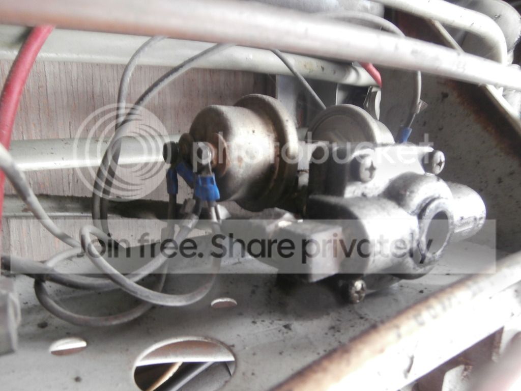

jav9956
Here is the break in question. Interestingly enough I did not hear any issues when reversing this weekend. That is either very good or very bad. I have not played around with any adjustments as of yet. To my untrained eye these are not automatic slack adjusters but perhaps someone who knows what they are talking about can fill me in!

lostagain
That is a manual adjuster. The spring loaded lock ring around the adjusting bolt should be out farther and almost even with the outside edge of the nut. When you are done adjusting, you turn the bolt a little one way or the other so the ring springs up to lock the bolt in position.

buswarrior
Needs some grease via the zerk, and some penetrating oil around the collar to free it up.
This whole area would benefit from the pressure washer.
A caution, all that crud ends up on the ground. Don't wash it off someplace that will get mad at you for the mess.
happy coaching!

brmax
Jav, its a standard time for the putty knife and a pan. I'm passing on that scraping party.
Only in an emergency would I adjust without a bit of scraping. I tell you I still to this day haven't got a "shorty spray wand" but musta swore a hundred times I would!

Allison
it is clearly evident that those have been neglected... but... they are in the wide open, easy access (many are not)... I would remove them and scrape clean and soak in diesel then re grease...pull the pin and a snap ring... easy peasy...  ;D
and heck the clevis for wear too they are cheap...

buswarrior
Accumulated dirt like that is evidence that nobody has touched that adjuster in some time.
That suggests to the experienced eye careless preventive maintenance.
In a commercial enforcement situation, it would attract unwanted attention, like waving a flag in front of a bull.
And excess grease hanging around helps start those wheel end failure fires.
Clean equipment is easier to maintain, and sends the message you want: Somebody cares about this vehicle.
Nobody wants to unwittingly attract the attention of an enforcement officer, and getting full body dirty every time you go near the coach gets old fast.
