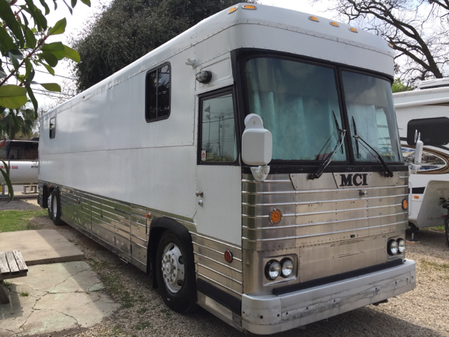

Been having trouble with the front bags holding up overnight ever since I got the bus back from the shop. Just can't get the beads to seal up on two of the block off plates. Tired of messing around with it so I just bought the rolling lobe retrofit kits from Mohawk. 1700 and some change for all 8. Let the fun begin!

I converted my airbags to a manual system years ago for levelling. Before the bus sat at the shop for the last 5 months it would hold air pretty much indefinitely. I replaced 2 front bags about 5 years ago, all the others are dated 1992. 24 years is a long time for rubber so I'm not complaining. I replaced all 4 front bags to the new rolling lobe today, took about 5 hours total. I expect the rear will take about that much time each side. I also took advantage of the easy access to adjust the brakes while in there.
