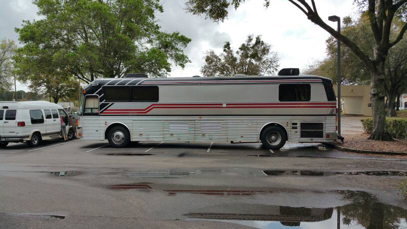

Prevost Question
Started by bigred, February 10, 2016, 08:32:17 AM
If you already are at close to 23,000lbs on the driver and have 12,000lbs on the tags, if you lift the tags, the drivers will be overloaded to the point that the air bags will not lift the bus back up. Good Luck, TomC
