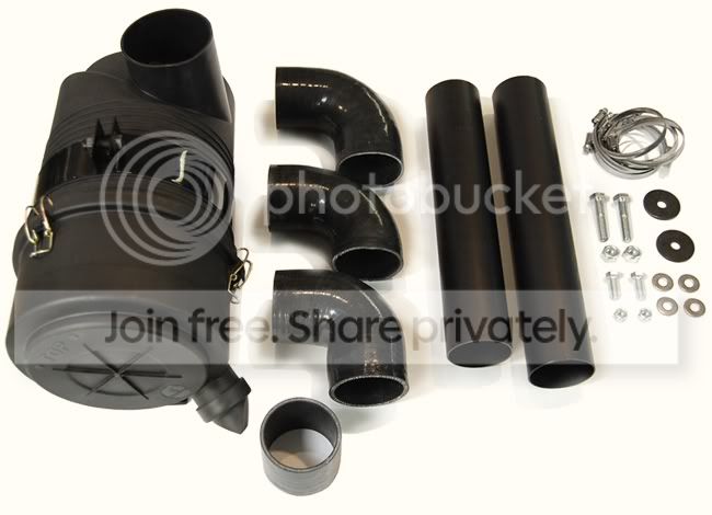

I am still at it, just about all done on the engine and engine compt as you will see in photos.  I have one question and will indicate which photo I am needing advise on, there is a inlet /outlet on my filter canister and I have no idea what goes there.  I believe 13 years AGO there was nothing but I know there has to be something to filter this end of the canister from animals, dirt etc.  Can anyone advise me that knows.

NOTE: the bottom photo and the center of the air canister is the fitting I am talking about needing protection from critters etc.

the bottom tube has/should have a rubber cone. it is a dust ejector and relieves moisture.
similar...Donaldson calls it a vascular valve... IIRC... ooops its a Vacuator valve....:)
http://www.steinertractor.com/ABC1765-dust-unloader-valve-vacuator-valve-for-dry-air-cleaners
http://img.photobucket.com/albums/v690/ride1099/DSC_0013b.jpg
