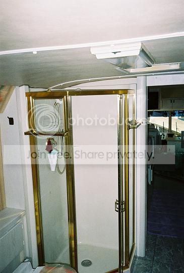

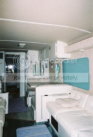

This is what is in my coach, the bath area is Naugahyde (tan/beige) and a burlap/tweed (tan/beige) in all of the other living areas, with oak painted white wood strips with plastic screw button covers to hide the seams and help hold the panels in place.

We used commercial wall covering for the ceiling in the 4107.  It is the same product you see on office cubicle walls.  It absorbs sound, wears like iron, and glues up. It is priced pretty well also.
Don and Cary

Cary and Don
If you have a large paint store with a good wallpaper department they will carry it.  Home Depot, probably not.  Most of the on line wallpaper places probably carry it.  They will send you samples. The stuff comes on big rolls 54 inches wide..  Unlike wallpaper, you buy it by the yard.
If we were to do it again, we would apply it to thin flexible panels and then install the panels.  That is easier than trying to get that heavy stuff to stay up over head until the glue grabs.  That is how the factories do it.
