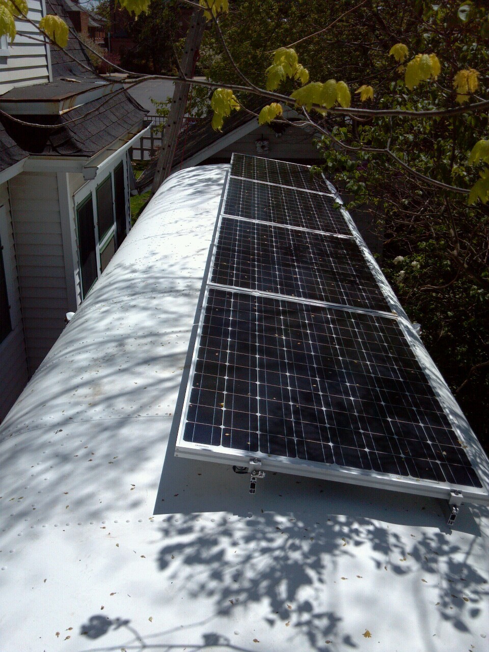

As you can see the roof is covered (about 30% with solar electric panels)

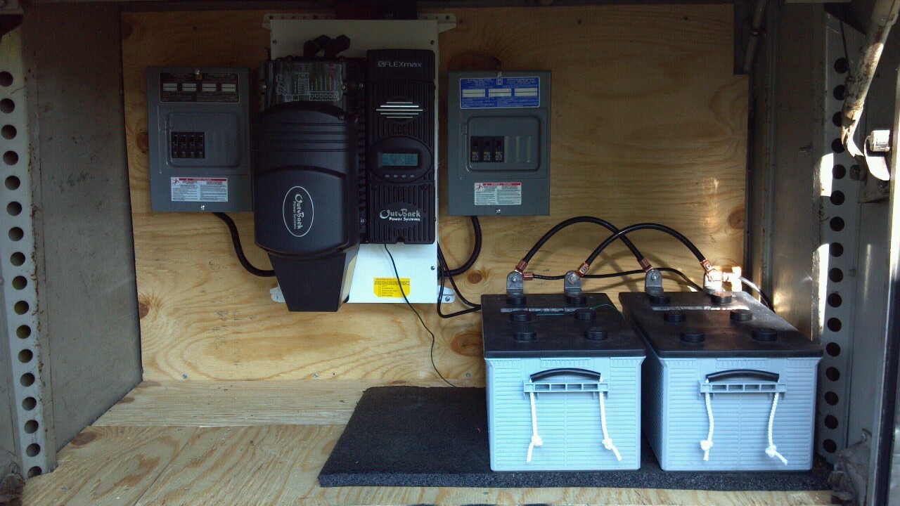

This plc shows the inverter, charge controller and all of the fuses, breakers, disconnects... and the old batteries - I will never buy AGM batteries again.
