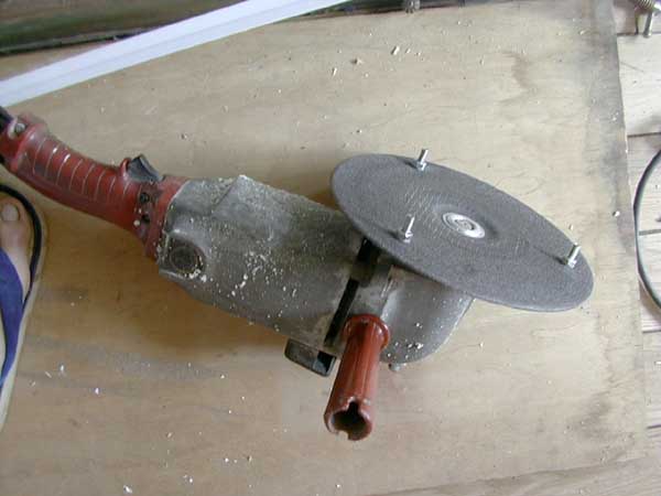

There is a large cast iron drum attached to the input shaft of the rear end with linkage to the brake shoes within. I had to use a large grinding wheel to cut the drum in half,, and when it came down it was HEAVY!.. I removed it to gain exceleration and help with stopping, and this drum being a rotational force makes a difference.. My service brakes were spring type so the hand brake was not needed.>>>Dan

Those damn things are incredibaly heavy, I found it makes a difference in excelleration and braking do to rotational forces. The only way to remove it with out removing the input yoke,(major job) is to cut it in half and let it drop down,(preverably not on your leg).>>>Dan
