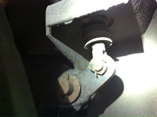

It is fixed...
I called Worldwide Equipment in Cincinnati. (Business Card Below) They are listed on the Prevost website as a certified repair center. They sell and work on Volvo so they do more work on Volvo engines in Prevost busses than they do on the rest of the Prevost systems. They were upfront about that on the phone but they were pretty sure they could take care of the air leak I described.
They lifted the bus while it was running and I lifted the tag so they could spot the air leak. The mechanic could not find a leaking valve underneath but found the big leak was in the canister on the side away from the tire. When he took it apart the rubber diaphragm was not in terrrible condition but it was completely out of place.
This is the connection below the canister and he discovered that the pin and clevice and was frozen and would not allow that rocker arm to move properly. He thinks this put stress on the whole system and pressure on the diaphragm and moved it out of its proper place in the canister. It took him quite a while to "unstick" the joint for lack of a better word. Even though the diaphragm wasn't bad he replaced it since we had a new one and it is so cheap. I am sure it has been in there for years, possibly 17 years.
Here is a picture of it from the other day...
