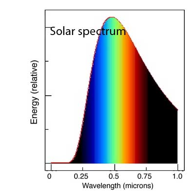

The piece you probably don't understand is that "white" light as supplied to up by our sun (or an incandescent lamp) is a continuous spectrum of light  comprised of all colors or wavelengths of light..
These light sources are called "black bodies", which basically describes black things that are so hot that they emits visible (and invisible) light... The ratio of bluish light to reddish light that they emit has to do with how hot they are- that's where the kelvin temperature comes in.  Hotter (higher kelvin temperature) equates to light that is visibly bluer, but in all cases if you put the light from a black body source through a prism, you'll see a continuous rainbow of all colors making up that "white" light.
That's what we as humans have gotten used to over the last few million years, and what our bodies are programmed to react to.

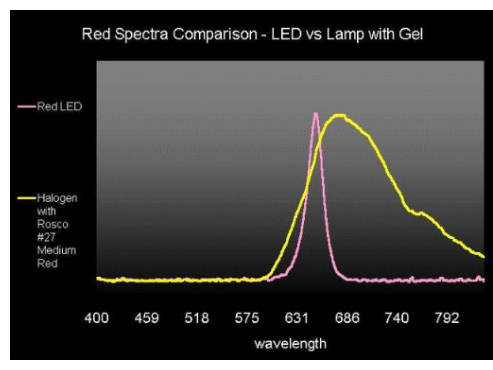

LED's on the other hand, are devices that emit very specific, almost single wavelengths of light.  For example take an incandescent lamp and stick a red gel over it to make red light.
If you put that light through a prism you will see a broad spectrum of light.  But put the light from a red LED that "looks" to be the same color through that prism and you'll see only one narrow band of color.  Take a look at this graph... the yellow line shows the spectrum of a light bulb filtered by a red gel, which is a fairly constant spread of wavelengths between 600 and 750nm.  But the LED which "looks" the same is only a very narrow band of light centered around 635nm or so.
That is what these guys are talking about.

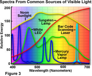

This chart shows the wavelengths of various lights that we're used to seeing, and other than the bar-code laser, most of the others can roughly be perceived by us as white light.
Its interesting to see how very different they are!

Thanks, Boogiethecat, now I know!   This forum's amazing  -  there's always someone who can explain the what and why behind the story.   Melatonin or not, I think most of us will still choose LEDs because of their lower power consumption;  maybe they'll also evolve in a few years to more closely mimic natural light.
