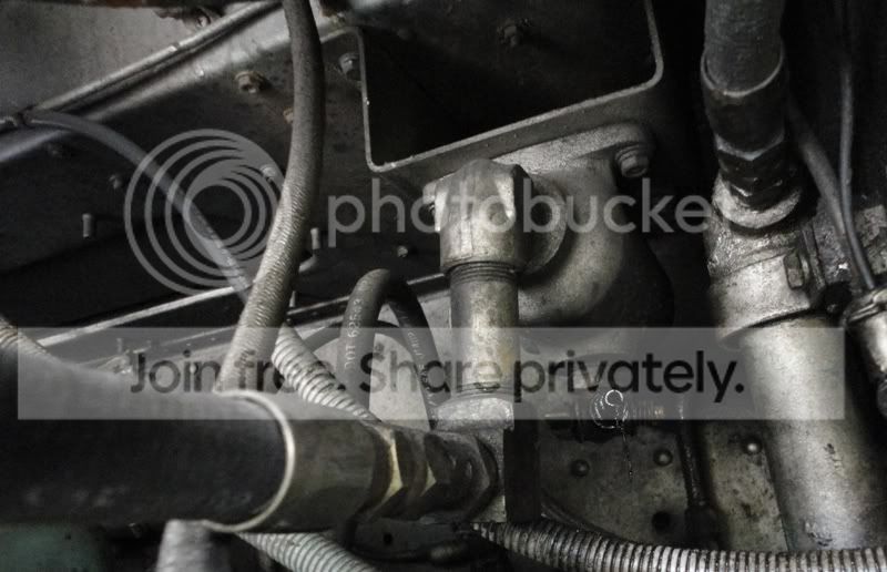

How do I check differential oil on my 83 prevost. I have looked all around it and only see what looks like an adjustment bolt with a lock nut. Out side of that there does not appear to be anything unless it is on the axle tube somewhere.

I wouldn't know what an adjustment bolt with a lock nut on a rear diff would be for. If that bolt is about where a fill plug should be, I would pull it and see if that is where the plug was. It could be, someone messed up the threads on the housing and used a bolt with a locknut to keep it in there.

Don't fool with the adjustment bolt that is the thrust adjustment for the ring gear keeps you ripping the teeth of the ring gear

Yeah I was not going to try and mess with that. I will crwl under again and look for the plug but I did not  even see a drain plug. I will keep looking.
