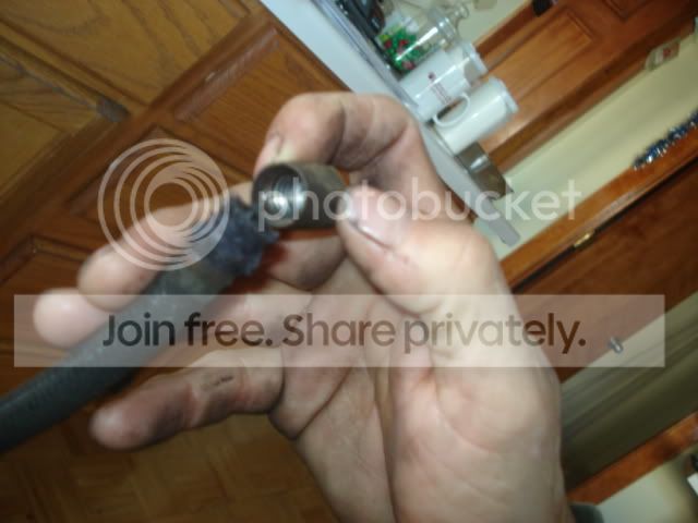

The tank is out, so much diesel and oil no problem loosing the nuts, one stud is bent big time. not sure if I what to try and straiten it, (sometimes you are opening a bigger can of worms). Both fuel lines have been replaced (do not like were they ran one of the lines, under the coach) so that will change, also, it works, but they pick up the fuel for the genset from the drain hole (did put in an internal pipe) but what a bitch, can not drain tank of the last 18 gals with out unscrewing the valve, so that will be changed. Not sure if  that pick up tube was high enough anyway. If there is 20 Gals of unusable fuel for the engine and I drain only 18 gal, I think there could be a problem. I now need to plug all the opening of the tank get some air pressure in to see were the leak is coming from.

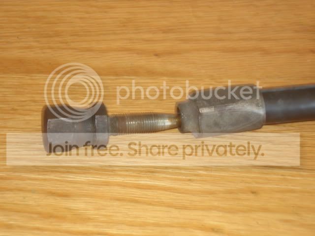

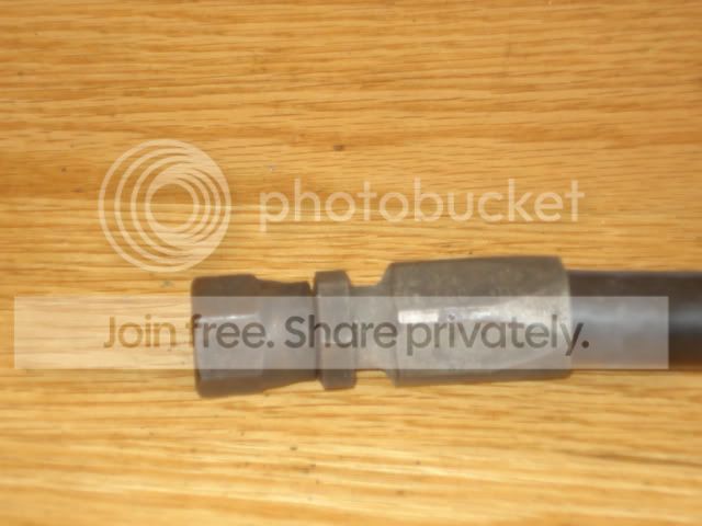

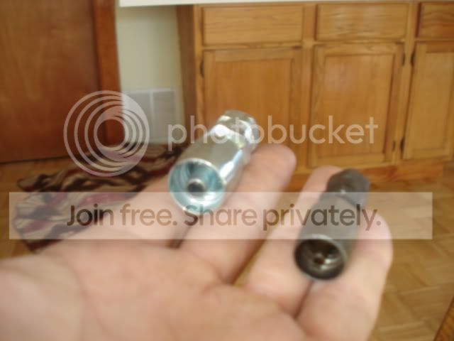

Have not looked for the leak yet, the tank has been repaired before I think it is leaking at the repair. There was a 1/4 in. ply and carpet under the tank, I am assuming this was done to help buffer the tank from the metal supports or did the tank always have plywood on the bottom side?:. As I was cleaning the fuel lines I noticed they are air lines, fuel and return lines on engine and genset are made of air lines. Is this doable and right?
Robert
1962-GM-4106
robertglines1
I would use fuel rated hose. to stop any possibility of failure or seperation or colapsing is short the right hose for the job. Sometimes short cuts come back on a fellow in the middle of no where in the middle of the night.  Good luck Bob
