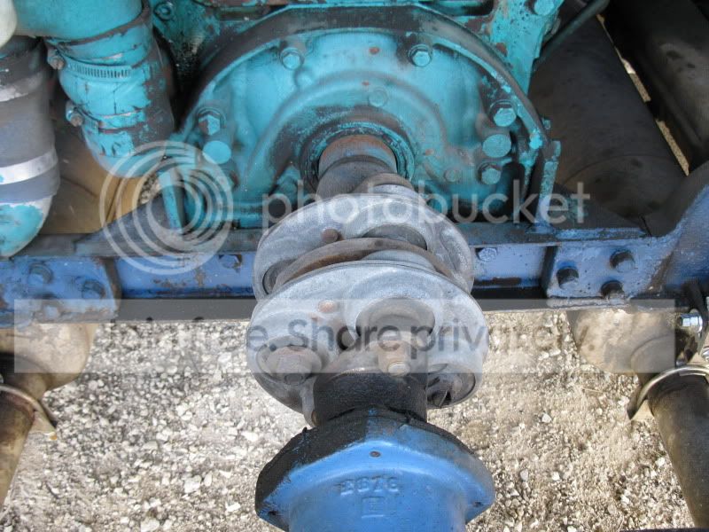

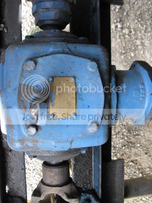

Andy, What is your VIN#? My parts book might have the seals you need listed. At least it might give you a head start.
Here are a couple of pics from mine. I know yours is an 05, but the 01 is very similar. For identification purposes only.

Paul, I just had to moderate you there buddy LOL Your mitre is a little different than his the main shaft goes through the box on his with a coupling and a balancer on the back the V6's use your style, don't ask why Eagle did that because I have no answer they just did.
His Morse coupling is probably going bad coming off the engine when they start to go bad  it will usually start the mitre box seals to leak have you checked yours lol
The coupling still looks pretty solid. Our problem is the bus sits for long periods and the seals dry out. And who knows how old they are  :(
When I was looking at my manual today, they looked the same. They did have different seal numbers. I better get my glasses changed. ;D
Trust me on this one Paul the 6v and 8v uses different mitre  boxes
