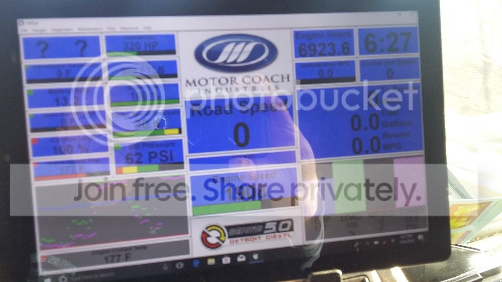

Ever since I got this bus the water temp gauge in the dash (electrical MCI) has not been accurate. After learning that the overheating shutdown and engine bay gauge (mechanical) worked properly, I let it be for a while.
It's time to fix it. It's the only gauge in my dash that doesn't work properly. It appears to read about 30 degs lower than the engine water temp gauge.
I cleaned the connectors and when I grounded the sending unit, the needle on the dash gauge shot right over to the right. This made me think that the sending unit needed replacement. I got the number off the unit (334R by Stewart Warner) and replaced it. Now it pretty much reads the same as before maybe a few degrees higher.
Before I start my testing for bad connections and old wire, is 334R the correct water temp gauge for this MCI gauge?
