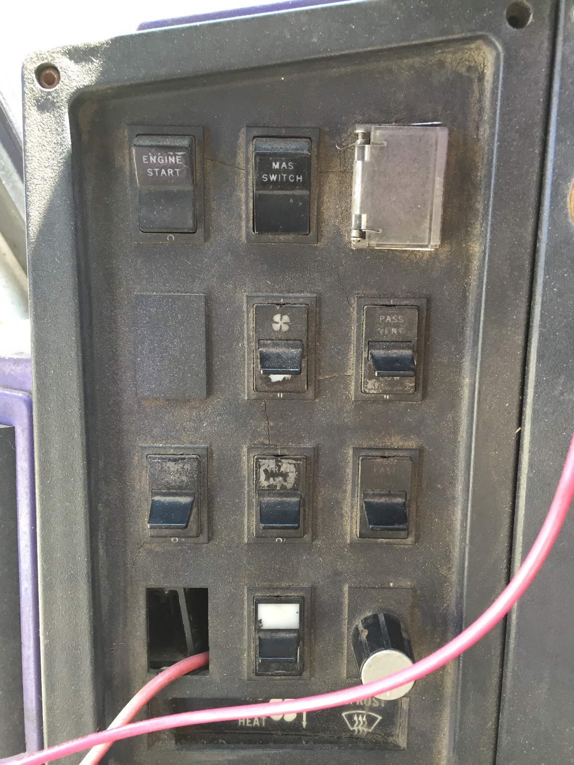

I have two panels. The one in front of my left armrest has the "set/coast and "resume accelerate" switch. But is there a switch somewhere to turn cruise "on"? I have switches on the dash but the labeling has worn off or the switch punched through. Can anyone take a high res photo of their 102 or 102C3 dash so I can see what switch is where? This would be hugely helpful. Thank you so much guys.

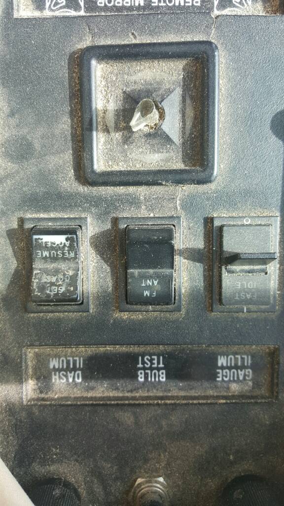

Scott the switch to the far left of the one you mentioned  should be the on off switch. It is on mine.
The one that says fast idle on mine is actually the on off switch. A few of my switches have been replaced and the label does not agree with the function, but the location of the switch agrees with da book.

Don't know why it posted upside down, but just flip your computer over lol

Interesting my fast at all switches there as well I never thought that that might be the issue. Let me check

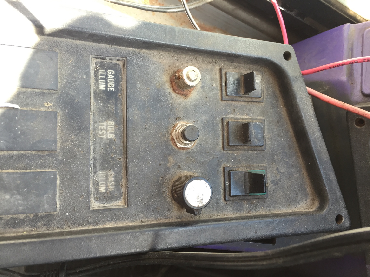

on mine the switch to turn cruise on and off is the one above your dash iLLum or top right switch on that panel . 4 pins 2 for the switch light and 2 for the switch .... simple    the switch to the left is for resume and accelerate  on the cruise
hope this helps
