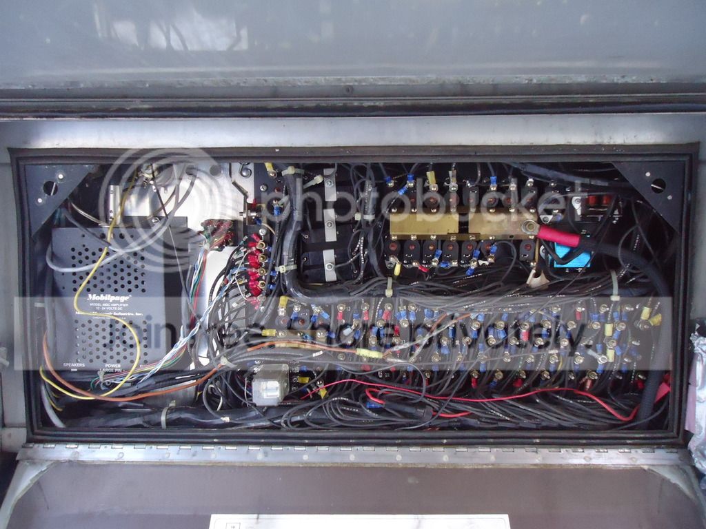

So when i bought the bus the turn signals work but they do not flash. i opened the box and its only connected to 2 places. where does the third wire go. ( i do not see a third wire bu i know they need three ) so if someone could send me a picture of there electrical box that would be awesome.
I have a 1980 MCI MC9 the inside box under the drivers window.

I have a 84 mc9, I will get a pic for you tomorrow afternoon.

My 1989 schematic shows one wire (X terminal, or power) goes to a 15 amp breaker on the bus bar, second wire (L terminal, or load) goes to the turn signal switch on the steering column and the third (P terminal, or Pilot) wire goes to the tell-tale pilot lamp on the dash.  A 1980 schematic version used only the X and L terminals, nothing on the P terminal, and the L terminal went to a turn lamp relay.  The later model did not have a turn lamp relay.  Your 1980 bus should be the earlier set up, so one side of the flasher should be power from the breaker on the bus bar, and the other side should go to the turn lamp relay.  Nothing on the third terminal of the flasher.

This is what I have . . . hope this helps. (i am still learning this photo stuff)
